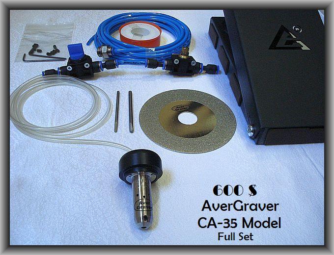

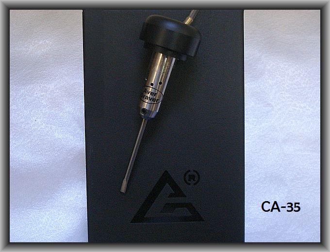

AVER GRAVER HAND CONTROL
Aver Graver Hand Control Engraver works only by hand control with no pedal.When the engraver tip touches the surface and you press the end part,it starts to operate.The speed is adjusted by pressing the handle part,and the pulse power is adjusted by turning the adjustment ring on it.By turning the adjustment ring clockwise , pulse hardens;turned in the opposite direction the effect is reduced.It can be adjusted according to the hardness of the metal used.It is a product of superior performance and can be used with no effort.Even disabled people can use it.The handles part is made from teflon ; all the other parts are made of high quality hardened stainless steel.It does not require lubrication, and other similar treatments.

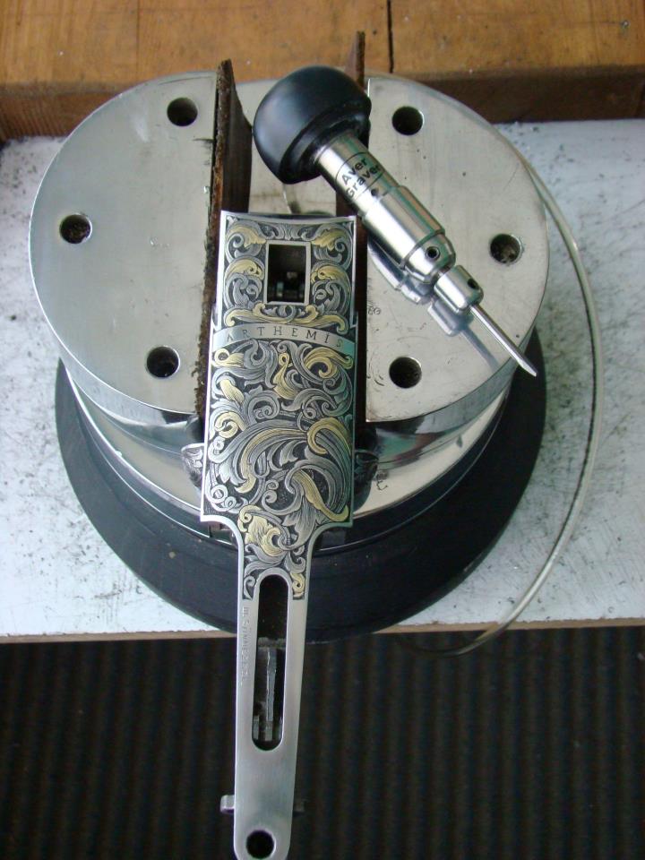

(engraving pen studies with)
